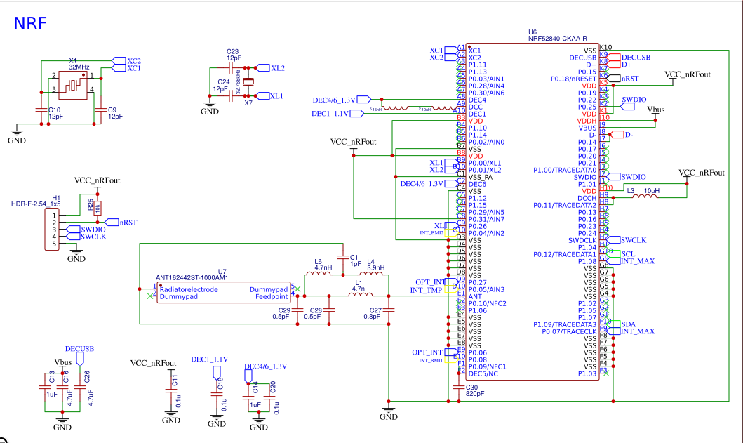

We're currently developing a zephyr firmware on zephyr 4.2 and we got a custom board for our hardware powered by an nrf52840-ckaa-R

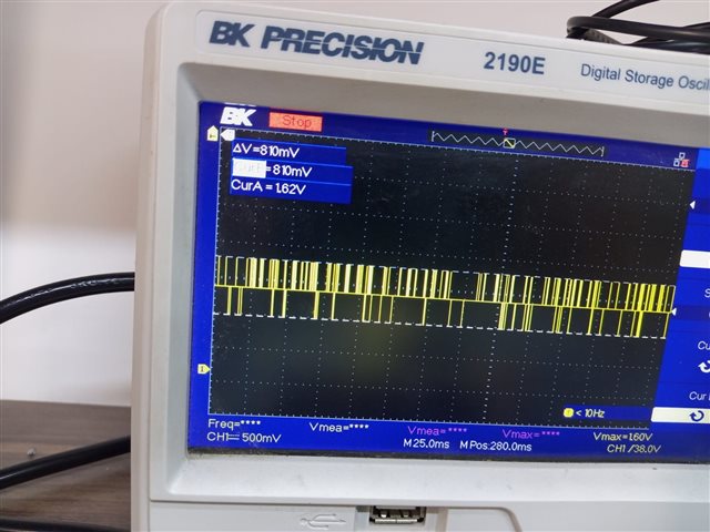

what's weird is one time I got to actually do the eraseall command despite the Failed to power up DAP showing up
I tried getting the nrf into bootloader mode by holding reset and powering the device up
I tried lowering speed for JLink
I tried powering the device and connecting the device, as well as running nrfjprog --recover/--eraseall in a loop while connecting and disconnecting the device
nothing works out

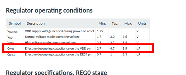

hardwarewise the DC/DC converter seems to be working so the nrf is functional (at least to an extent I guess)
Is there any way to debug this or is my device just bricked?
