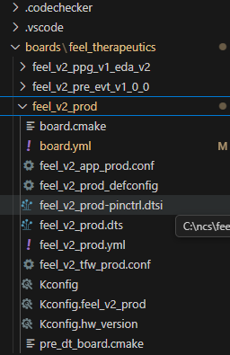

I have set up some tests using the ZTest environment based on the test sample in ..\v3.0.2\zephyr\tests\bluetooth\adv\. for my custom project which has custom boards that has been deployed on this HW and is working as expected for 2 years. The custom boards were created using the "Create a new board" feature of the nRF Connect VS Code Extension (from v2.5.2 version of the SDK). I have also followed the file and project configuration of the sample test in my custom application and also looked up all relevant documentation and asked tha same question to the Nordic AI for help.

where feel_v2_pre_evt_v1_0_0 & feel_v2_prod are two of the custom HW boards that my application is used on. Even if ommit specifiyng the board in the twister command I get the same results.
Below are the files included in the tests directory of my custom application for your review:

Could you provide some help on why this error is being produced? Do I have to setup my custom boards differently o be recognized by the ZTest framework or twister?
