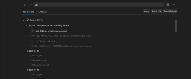

the DHT sensor is well activated in KUI Config :
