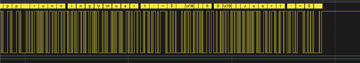

On a logic analyzer I see:
For the DK board, a normal behavior of the TX pin.
[00:33:45.115,979] \x1B[0m<inf> main: app running\x1B[0m
\x1B[8D\x1B[J[00:33:45.115,979] <inf> main: app running
uart:~$ \x1B[8D\x1B[Juart:~$
On our own board however we see strange characters that don't seem to follow the Baudrate set. The logging line is fine so My uart is set at the correct baudrate. but anything shell related is not as expected.
[00:00:20.002,637] \x1B[0m<inf> main: app running\x1B[0m
\x1B\xFF\0\xFE\xFD\x01\0\x07\0
So the logging both say "App running" and then we expect the shell but on the own developed board we do not get the correct characters.
Also typing a command like 'help' does not trigger anything, where I was expecting a reaction on the TX line as the character typed should be echo'd...
