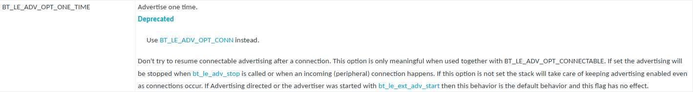

I am trying to implement some power saving features of my device, and am having trouble with stopping advertising in SDK v3.1.0
I would like to advertise for 1 minute, and then stop. A button press would resume advertising with the same timeout. I do not need the device to advertise 24/7
It looks like setting BT_LE_AD_LIMITED for bt_data inside bt_le_adv_start , and setting CONFIG_BT_LIM_ADV_TIMEOUT=60 allows me to implement the timeout feature. However, in SDK v3.1.0, advertising immediately restarts after stopping. It seems that there used to be an option inside BT_LE_ADV_PARAM to set advertising to one time. The alternative BT_LE_ADV_OPT_CONN does not seem to do this by default and I cannot find any instructions on how to implement this.

    I like the app logic that you used. However my trouble isn't implementing a timeout, but instead, that bt_le_adv_stop() doesn't permanently stop advertising.
    The issue is that advertising will restart immediately after bt_le_adv_stop() is called. It looks like the deprecated BT_LE_ADV_OPT_ONE_TIME config used to prevent this.

    I tested a minimal advertising setup in v3.1.0 and was able to stop it properly by just calling bt_le_adv_stop(). Maybe there’s something different in your configuration, or you’re doing some callback logic? Could you try starting and stopping advertising with a bare-minimum setup to compare?
    Also, the BT_LE_ADV_OPT_ONE_TIME option was used to prevent advertising from restarting automatically after a connection is closed.

    Thank you. I just noticed that my on_recycled() callback was restarting the advertising.
    static struct bt_conn_cb conn_cb = {
        .connected = on_connected,
        .disconnected = on_disconnected,
        .recycled = on_recycled,
        .le_param_updated = on_le_param_updated,
        .le_phy_updated = on_le_phy_updated,
        .security_changed = on_security_changed,
    Removing that logic fixed the issue.
