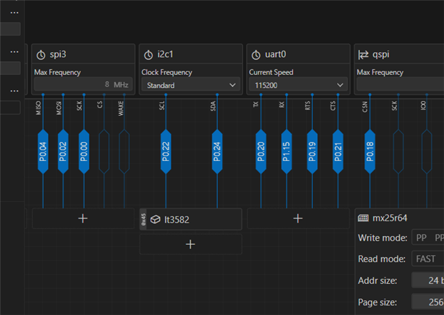

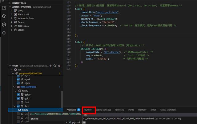

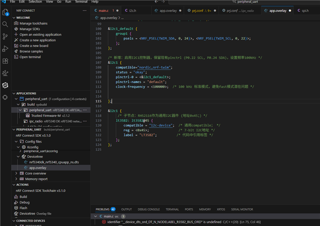

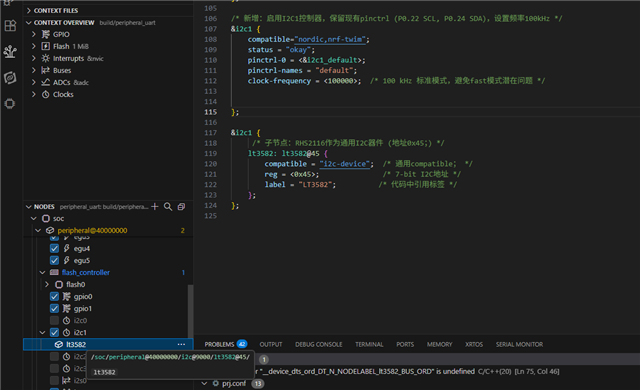

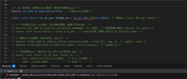

The child nodes of the I2C device tree cannot be parsed.
I am not using the nrf5340DK development board; instead, I am using the nrf5340 chip, and the SDK version I'm using is V3.1.0. I defined the I2C child node "lt3582" in the device tree, and this child node is also visible under the "i2c1" node. However, the function I2C_DT_SPEC_GET in the main function keeps indicating that this child node is not defined. Could anyone please help me with this?
