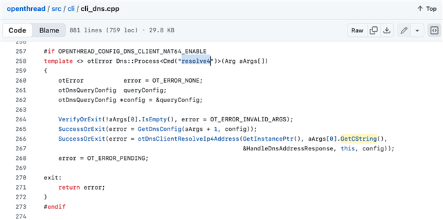

However, since I have multiple devices, it becomes inconvenient when the CoAP server’s IPv4 address changes. In that case, I have to manually check the new synthesized IPv6 address, hardcode it into the firmware, and re-flash all devices — which is quite tedious. To solve this, I’d like to implement a DNS query directly on the OT SED devices so they can dynamically retrieve the IPv6 address. Since the ot-cli sample is capable of performing this query, it indicates that such functionality should be possible to implement.
I inspected the ncs ot-cli sample repository but couldn’t determine which source files correspond to each CLI command, making it difficult to replicate the implementation. How does the build system for this sample work? Does it use the official Google OpenThread repository? I was able to locate the code executed for the dns resolve4 command there:
I tried implementing the DNS query using my nRF Connect SDK application (using NCS v3.1). The application builds successfully, but when I run it, I don’t receive any response. My implementation is shown below:

I'm getting the hard-coded default Google DNS from the OpenThread library instead of my local DNS64 server address (e.g., fd84:...). I know the local NAT64/DNS64 is working because when I use the ot-cli sample, I get the correct synthesized IPv6 addresses.
Are there any guidelines on what I might be missing and how to generate the synthesized IPv6 address in the firmware?
