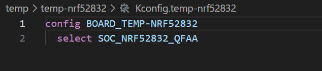

BOARD_TEMP-NRF52832 defined without a typeParsing error: Aborting due to Kconfig warnings
Hi All,

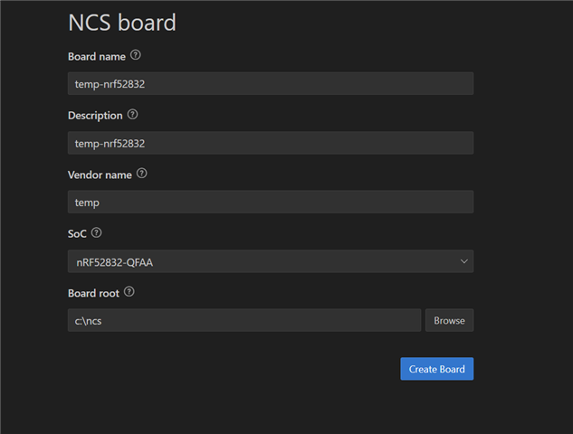

I have been trying to create new custom board. and havent been able to even build.
I followed the intructions here :
https://academy.nordicsemi.com/courses/nrf-connect-sdk-intermediate/lessons/lesson-3-adding-custom-board-support/topic/exercise-1/
have been getting this kconfig error:

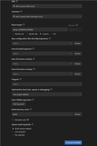

*  Executing task: nRF Connect: Generate config temp-nrf52832/nrf52832 for c:\Users\nithi\nordicfw\ncsfund\hello_world
Building hello_world
west build --build-dir c:/Users/nithi/nordicfw/ncsfund/hello_world/build c:/Users/nithi/nordicfw/ncsfund/hello_world --pristine --board temp-nrf52832/nrf52832 -- -DBOARD_ROOT="c:/ncs"
-- Found Python3: C:/ncs/toolchains/0b393f9e1b/opt/bin/python.exe (found suitable version "3.12.4", minimum required is "3.10") found components: Interpreter
-- Cache files will be written to: C:/Users/nithi/ncsdk/v3.0.2/zephyr/.cache
-- Board: temp-nrf52832, qualifiers: nrf52832
warning: BOARD_TEMP-NRF52832 (defined at C:/ncs/boards/temp/temp-nrf52832/Kconfig.temp-nrf52832:1) defined without a typeParsing C:/Users/nithi/ncsdk/v3.0.2/zephyr/share/sysbuild/Kconfig
Loaded configuration 'C:/Users/nithi/nordicfw/ncsfund/hello_world/build/_sysbuild/empty.conf'
Merged configuration 'C:/Users/nithi/nordicfw/ncsfund/hello_world/build/_sysbuild/empty.conf'

Board Definition:
Build Configuration:
The build fails every time.
I am using the hello_world project template.
