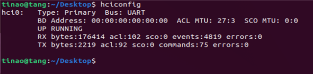

nRF54L15-DK used with BlueZ, connecting to other peripheral BLE devices, automatic disconnection after connection

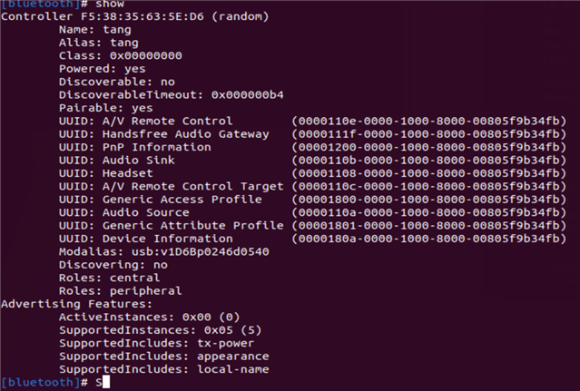

After using the official example hci_uart with the nRF54L15-DK, it is configured as an HCI controller. I used bluetoothctl commands like scan on and connect to scan for peripheral devices (dual-mode Bluetooth headphones and a BLE debug assistant in peripheral mode) and establish connections. Using info + MAC address, I could see the connect status displayed as yes, indicating a successful connection. However, the connection would disconnect after about a minute. Below is the event capture from btmon. I've tried various approaches, but this issue persists. I'm hoping you can suggest solutions. However, when I use nRF Connect for mobile as the host device to connect to the nRF54L15-DK, the connection remains stable. Why is that?
