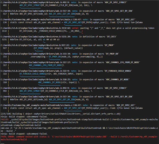

  • I am sorry for the late reply. Last week was my midterm week Smiley
    Can you run any BLE sample in the SDK ?
    I tried to build "peripheral_lbs" sample from sdk. I also get these errors from it (it does not use any pwm, or the example had any .overlay, I was getting the error):
    -- Found devicetree overlay: nrf54l15dk_nrf54l15_cpuapp.overlay
    devicetree error: 'pinctrl-0' is marked as required in 'properties:' in C:/ncs/v3.0.2/zephyr/dts/bindings\pwm\nordic,nrf-pwm.yaml, but does not appear in <Node /soc/peripheral@50000000/pwm@d3000 in 'C
    :/ncs/v3.0.2/zephyr/misc/empty_file.c'>
    CMake Error at C:/ncs/v3.0.2/zephyr/cmake/modules/dts.cmake:305 (execute_process):
    execute_process failed command indexes:
    1: "Child return code: 1"
    So I made an overlay file and disabled the &pwm20 node, It still gives the same error when building..

  • Hi Mert,
    I couldn't build your project here due to some device tree issue I think.
    But I think it's important to make sure your DK can run a simple BLE application. My suggestion is to try downloading a fresh NCS SDK (latest version now is v3.1.1)
    Please try to test with non _ns board. Have you gone through our academy courses  ? https://academy.nordicsemi.com/
    Please also try get hold of a 2nd board, just in case there could be a problem with the board you have.
