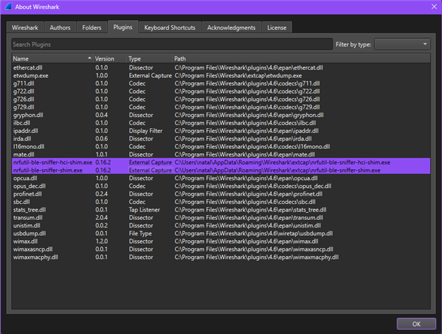

The nRF Sniffer for Bluetooth LE plugin is correctly detected by Wireshark and visible under
Help → About Wireshark → Plugins (as shown in the attached screenshots):
nrfutil-ble-sniffer-hci-shim.exe   0.16.2   External Capture
nrfutil-ble-sniffer-shim.exe       0.16.2   External Capture

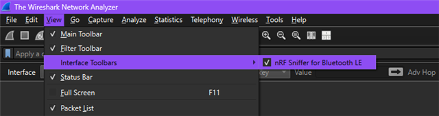

Additionally, the Interface Toolbar → nRF Sniffer for Bluetooth LE option is available under the View menu.

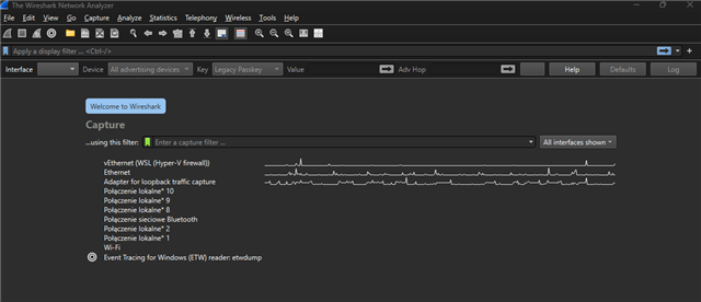

Despite the plugin being properly detected, no sniffer intefaces/devices appear under the Capture tab in Wireshark.
Debug Logs
For debug purposes I've started Wireshark from a command prompt with:
"C:\Program Files\Wireshark\Wireshark.exe" --log-level debug --log-file -
After performing Capture → Refresh Interfaces, the log shows that extcap discovery completes and the nRF Sniffer shims are loaded:
** (wireshark:6480) 11:52:48.812153 [Extcap INFO] -- extcap: completed discovery of 3 tools in 248.346ms
** (wireshark:6480) 11:52:48.812892 [Extcap INFO] -- Loading interface list for C:\Users\natal\AppData\Roaming\Wireshark\extcap\nrfutil-ble-sniffer-hci-shim.exe
** (wireshark:6480) 11:52:48.813524 [Extcap INFO] -- Loading interface list for C:\Users\natal\AppData\Roaming\Wireshark\extcap\nrfutil-ble-sniffer-shim.exe
However, the sniffer devices do not appear in the Wireshark interface list.

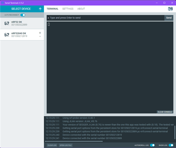

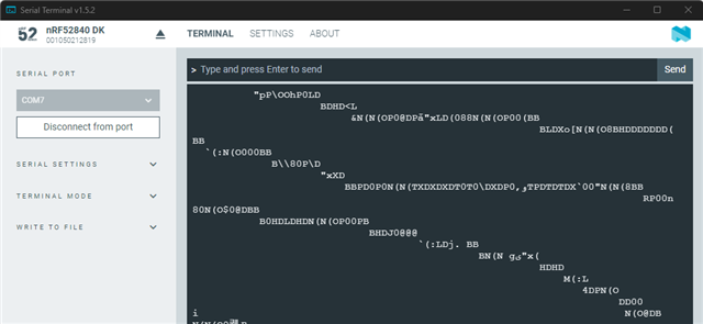

Additional Verification
Devices’ serial ports are correctly detected in other software.
Using nRF Connect for Desktop – Serial Terminal, both boards (nRF52 DK and nRF52840 DK) appear and connect successfully via their serial ports.
Communication works without issues, and data can be read from the devices as expected (see attached screenshots).

Even though the nRF Sniffer for BLE plugin is correctly installed, detected, and initialized within Wireshark (as confirmed by plugin listings and logs), the sniffer interfaces do not appear in the Capture list.
The extcap executables (nrfutil-ble-sniffer-shim.exe and nrfutil-ble-sniffer-hci-shim.exe) both fail to enumerate devices and terminate with exit code 101 caused by an unhandled Option::unwrap() error.
