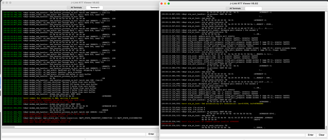

Here's the log on the HOST (nrf54):
[00:00:13.189,568] <dbg> modem_cmd_handler: modem_cmd_send_ext: SENT DATA
                                41 54 23 58 53 45 4e 44 |AT#XSEND
[00:00:17.735,136] <wrn> comms: Not connected to AWS, waiting 5 seconds
[00:00:18.192,960] <err> modem_nrf91: AT#XSEND failed or timed out (err -116)
[00:00:18.192,992] <err> net_sock_tls: TLS handshake error: -0x4e
[00:00:18.195,872] <dbg> modem_cmd_handler: modem_cmd_send_ext: SENT DATA
                                41 54 23 58 53 4f 43 4b 45 54 3d 30 |AT#XSOCK ET=0
[00:00:18.201,280] <dbg> modem_cmd_handler: cmd_handler_process_rx_buf: RECV
                                45 52 52 4f 52 |ERROR
[00:00:18.201,280] <dbg> modem_cmd_handler: cmd_handler_process_rx_buf: match cmd [ERROR] (len:5)
And here's the log on nrf91 SLM:
[00:00:12.397,003] <dbg> slm_sock: update_work_fn: Update poll events
[00:00:12.397,155] <dbg> slm_sock: update_apoll_fds: fd: 1, events: 0x0001, revents: 0x0000
[00:00:12.397,186] <dbg> slm_sock: update_apoll_fds: fd: 2, events: 0x0001, revents: 0x0000
[00:00:12.397,216] <dbg> nrf9x_sockets: nrf9x_poll_prepare: nrf9x_poll_prepare: modem socket 0 (app FD 1), events: 0x0001
[00:00:12.397,247] <dbg> nrf9x_sockets: nrf9x_poll_prepare: nrf9x_poll_prepare: modem socket 1 (app FD 2), events: 0x0001
[00:00:12.713,714] <inf> slm: I'm alive 3
[00:00:15.713,806] <inf> slm: I'm alive 4
[00:00:17.527,038] <dbg> slm_at_host: cmd_send: RX
                                41 54 23 58 53 45 4e 44 0a 41 54 23 58 53 4f 43 |AT#XSEND .AT#XSOC
                                4b 45 54 3d 30 |KET=0
[00:00:17.527,099] <err> slm_at_host: AT command syntax invalid: AT#XSEND
AT#XSOCKET=0
[00:00:17.527,191] <dbg> slm_at_host: slm_at_send_indicate: TX
                                0d 0a 45 52 52 4f 52 0d 0a |..ERROR. .

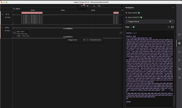

  • I don't have traces but I did more digging and it seems to be related to the timing between sending AT#XSEND and the EOL (\r\n). Zephyr's `modem_cmd_handler.c` handles this as 2 writes
    iface->write(iface, buf, strlen(buf));
    iface->write(iface, data->eol, data->eol_len);
    So, depending on what else is happening in the application, there could be a meaningful delay between the two. I noticed that when the delay is right around 2ms, the last byte of the EOL (\n) is missed.If the delay is shorter or longer (>3ms), then everything works fine. 2ms just happens to be the UART_RX_TIMEOUT_US on the SLM.
    In this case, note that the logic analyzer shows \r\n being sent. But only \r is received. I'll post the AI assessment of the UART issue below.
    AI assessment:
    The Race Condition
    When the delay is just over 2ms:
    1. First part of command arrives (e.g., AT#XSEND=...)
    1. Timer starts counting down from 2000us
    1. At ~2000us: timeout fires → rx_timeout() executes
    1. At ~2000us: RXDRDY is checked → likely false (no new byte yet)
    1. At ~2001us: \n byte arrives on UART line
    1. At ~2001usSTOPRX is triggered (from step 4)
    1. Result: \n may be missed because:
    • It arrives after the timeout check
    • STOPRX may interrupt an in-flight byte
    • The ENDRX event may fire before \n is fully received
    Why Shorter/Longer Delays Work
    • Shorter delay (< 2ms): All bytes arrive within the timeout window → batched together → \n included
    • Longer delay (>> 2ms): First part times out and is sent → \r\n arrives later as a separate transmission → gets its own event
