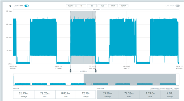

I am testing modem power consumption in the scenario where the modem does not have cellular service (CEREG: 4). Essentially, I am disconnecting the antenna from our board to simulate this scenario. A shield box would also achieve the same results. These are my current measurement results:
This is on a custom board so the currents won't match a nRF9151DK exactly, but the takeaway is that the modem stays in a periodic high-current on state while searching for a network indefinitely it seems. I have only monitored this condition for 10-15 minutes with the power profiler kit 2. Based on the above, I have a few questions:
1. Does Nordic employ any power saving techniques when the nRF9151 module doesn't have cellular service (Out of coverage)? If so, what are they?
2. If the answer to #1 is no, then I assume it is up to the developer (me) to implement my own power saving techniques in the event of no cellular service?

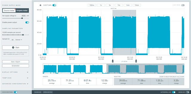

  • Hey Øyvind,
    Thanks for your reply! That is a neat and useful feature, but I don't think it applies to my specific test case. To confirm, I tested this feature by adding AT%FEACONF=0,4,1 to my modem power on routine. My current measurement results are exactly the same as without this configuration as seen below.
    I queried the modem to make sure FEACONF=0,4,1 is set, and this is what I get:
    ATCMD_PROC: (cli) Executing: AT%FEACONF=1,4
    ATCMD_PROC: (cli) Response: %FEACONF: 4,1
    I also confirmed I am running mfw_nrf91x1_2.0.3.
    Looking at the name of this feature in the AT command document, it says "Disable paging reception in cells without usable service". This implies that it addresses the condition of when the modem is connected to a cell (tower) that doesn't have active service. The condition I am testing is when the modem is not connected to any cell and thus doesn't have service.
    Am I missing something?

  • Hey Øyvind,
    No worries, thanks for the update! This is very good information, thank you. I tested XDATAPRFL using the "Ultra-low power" mode and current consumptions are much better (Less periodic searching). I see that this can be further tuned with the PERIODICSEARCHCONF command. I will discuss this with our customer in a meeting later this week. Assuming I have no additional questions at that time, I will close this ticket.
