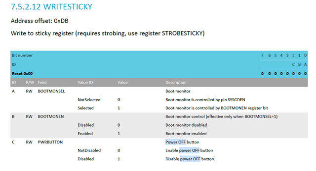

    To address your first question, yes, it’s possible to configure the SHPHLD pin to be used only for exiting ship mode and to disable the power-off button functionality. This is controlled by the “sticky” bit PWRBUTTON. After setting this bit, you must use STROBESTICKY. Note that this is still volatile memory even though these bits are named “sticky.” This means the values are retained as long as the battery voltage is present, and they don’t depend on the boost operation or VINT voltage as the normal registers.

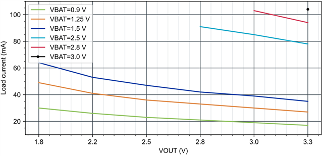

    For the second question, the maximum current for LP mode really depends on the input to output conversion ratio. There is no strict limit for it, but depending on the battery voltage and output voltage at some load the HP mode will be more efficient and it is better to use that instead of ULP/LP mode. This is handled automatically when the boost is set to AUTO mode.
    Further, you can see this "Load current triggering mode change vs. VOUT" figure in the datasheet which shows the typical load current threshold in Auto mode where BOOST changes from Low Power to High Power mode. Same limits applies for LP mode also.

  • To address your first question, yes, it’s possible to configure the SHPHLD pin to be used only for exiting ship mode and to disable the power-off button functionality. This is controlled by the “sticky” bit PWRBUTTON. After setting this bit, you must use STROBESTICKY. Note that this is still volatile memory even though these bits are named “sticky.” This means the values are retained as long as the battery voltage is present, and they don’t depend on the boost operation or VINT voltage as the normal registers.

  • That's, right. And to build on my previous reply. This functionality can also be achieved with device tree bindings (shiphold-longpress) and does not have to be done with manual register writes.
