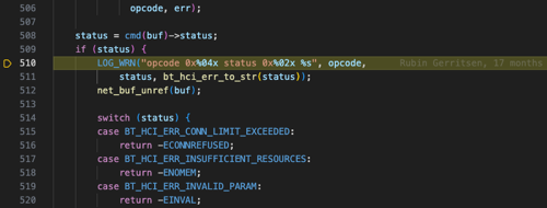

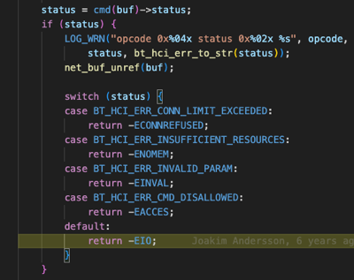

In debugging I see this:
and the since the status=1 the -5 value is returned:
Here are some more log entries:

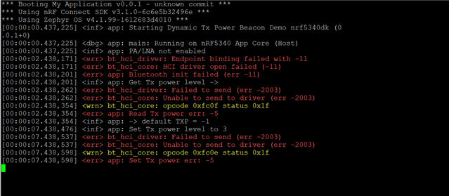

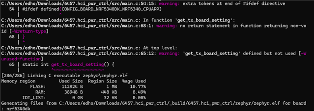

  • This is what I see when flashing your application.
    I removed the CONFIG_BT_LL_SW_SPLIT=y from your nrf5340dk_nrf5340_cpuapp.conf, as it is conflicting with the CONFIG_BT_SOFTDEVICE_CONTROLLER=y.
    lcj said:
    I've seen kconfig files but never created a kconfig.sysbuild. What directory does that go in? The only time I've edited the Kconfig is to create new settings.
    It is what generates the image for the network core on the nRF5340. (What NCS version are you using, by the way?)
    As you can see here, nothing with BLE is working. If it behaves different on your end, it is because the network core is still flashed from a previous application, and since your application doesn't contain anything for the network core, it is not erased or flashed.

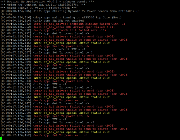

    I also commented out these Kconfigs from sysbuild\ipc_radio\prj.conf, because they were not defined (and made the build fail, once sysbuild\ipc_radio\prj.conf was actually included) :
    #CONFIG_BT_CTLR_VS_TX_POWER_WRITE_SUPPORT=y
    #CONFIG_BT_CTLR_HCI_VS=y
    #CONFIG_BT_CTLR_VS_TX_POWER_READ_SUPPORT=y
    #CONFIG_BT_CTLR_ADV_TX_POWER_CONTROL=y
    Also, I fixed some of the warnings from your build log:
    hci_pwr_ctrl2.zip
    Test the attached project (I tested in v3.1.1, and it seemed to work)
    And let me know if it doesn't work as intended.
    Edvin

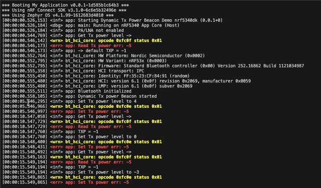

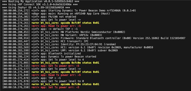

  • Interesting. I wasn’t getting the hci core errors. I was getting the warning and app error for tx write and read. I will try your code this evening. I’m on version 3.1. Thank you.
    When I ran it on a nrf5340dk I could see it in the iPhone nrfConnect app as "Dynamic test beacon" and my logs looked like this:
    I'm going to try your code now.

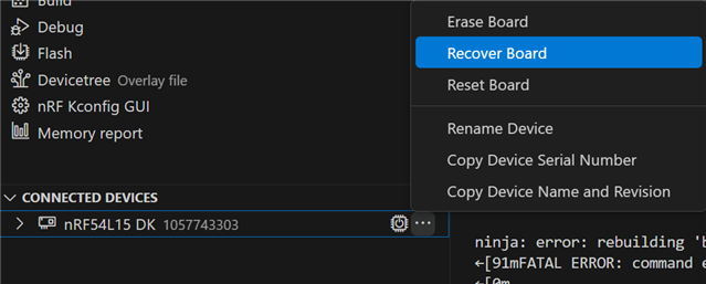

  • I suspect, since your app didn't include anything for the network core, that the network core was flashed with something from another application, and hence was flashed with a default BLE controller, without the Kconfig allowing it to change TX power.
    If you were to --recover the nRF5340 before flashing it, you would see that you will have an empty network core when you run your application:
    "west flash -d build --recover", or:
    (and then flash the application).
    Edvin
