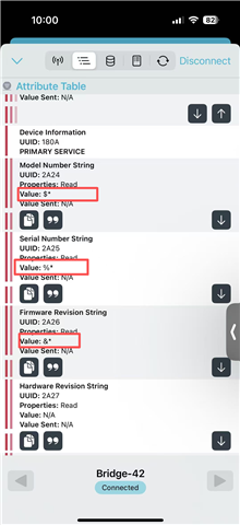

iOS BLE cannot correctly read the model number.

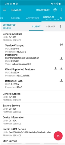

After updating from SDK V2.1.3 OTA to SDK V2.9.0, iOS cannot correctly read data such as the model number, but Android can read it normally.
Turn off Bluetooth in the system, turn it back on, and it can be read normally after connecting.

    That said, I got the v2.9 version built, but there was failure on the v2.1.3. That said, I was first interested in verifying that CONFIG_BT_GATT_SERVICE_CHANGED=y was enabled in the .config in the build, and it was. So the service changed characteristic is there in the old, which is good and essential. So this looks good so far, and I do not have a clear idea of what the cause here is.

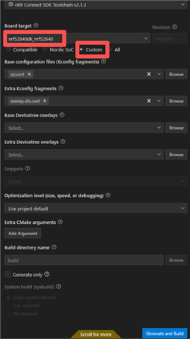

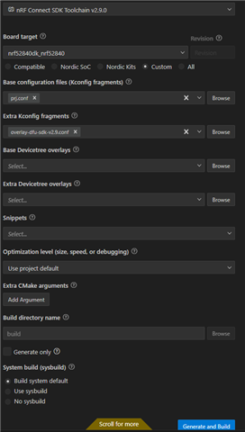

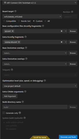

  • Hi Leo,
    Thank you. Can you share the exact way you build it (either with the command if you build from the command line, or a screenshot showing your build configuration if you build from VS Code)?
  • Hi Leo,
    I see. Have you done any other changes? When I build the 2.1.3 project it fails to build during linking where it cannot find mcuboot_status_change() This is while using your custom board in the project folder(called nrf52840dk_nrf52840):

    Can you see if you have done any changes to the SDK? And perhaps download a fresh 2.1.3 and build with that? I would like to be able to build both your project without any changes so that I know I am testing the same as you.
