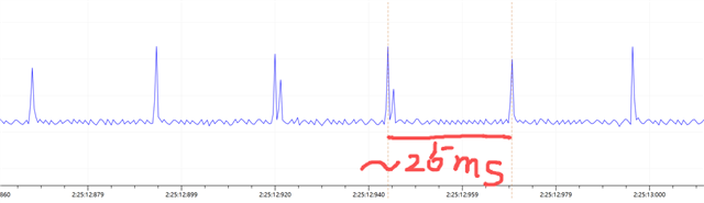

    2、Moreover, I've noticed something quite puzzling.
    With the same code, when using the nPM1300 power supply on the nRF54L15 PDK, the system is observed to wake up once per second and sleep the rest of the time. However, when the P6 interface on the PDK is powered by the nPM2100 (with the I²C interface disconnected), the power analyzer detects that the nRF54 wakes up every 20ms. It's unclear what the chip is doing during these wake-ups.

      The figure below shows the current consumption graph when connected to the nPM2100
    I tested again. When connected to nPM2100, with the nRF54's UART configuration enabled,
    CONFIG_LOG=y
    CONFIG_SERIAL=y
    CONFIG_CONSOLE=y
    CONFIG_UART_CONSOLE=y
    the wakeup period becomes 20ms. When the UART is disabled, there's an abnormal current spike occurring approximately every 500ms. However, this abnormal current does not appear when using nPM1300.
    I am bit confused as to what a test like this would show. The fact that the nRF wakes up in a different frequency confirm that either the voltage to the nRF is low enough to get some sort of brownout behavior, or that there is something with the input voltage that the nRF responds to in the sw. What are you running on the nRF?

  • I am bit confused as to what a test like this would show. The fact that the nRF wakes up in a different frequency confirm that either the voltage to the nRF is low enough to get some sort of brownout behavior, or that there is something with the input voltage that the nRF responds to in the sw. What are you running on the nRF?
    I  just use the demo of blinky, ncs 3.0.0
