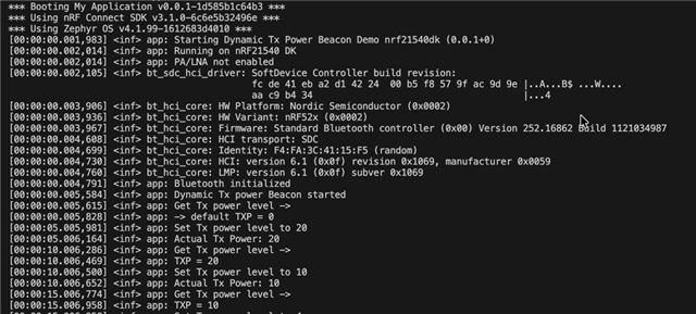

as I tried this in main.c:
	#ifdef CONFIG_BOARD_NRF5340DK_NRF5340_CPUAPP
		// Dual-core specific code for nRF5340 App Core
		LOG_DBG("Running on nRF5340 App Core (Host)");
	#elif defined(CONFIG_BOARD_NRF52840DK_NRF52840)
		// Single-core specific code for nRF52840
		LOG_DBG("Running on nRF52840 (Single Core)");
	#elif defined(CONFIG_BOARD_NRF21540DK_NRF52840)
		LOG_INF("Running on nRF21540 DK");
	#else
		// Default or unknown board
		LOG_DBG("Running on an unknown or unsupported board");
and got this in the log:
[00:00:00.000,488] <inf> app: Running on nRF21540 DK
I would also like to see how to configure the rx as well and set it to the maximum. Are the above configuration settings right? What should my txpower array be for testing? Do I need to do anything to test and confirm the rx settings?
