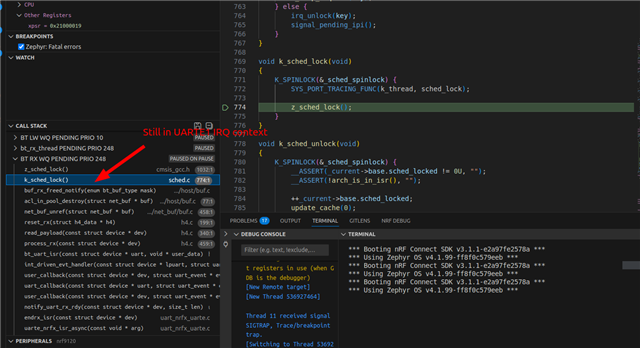

ASSERTION FAIL [err == 0] @ WEST_TOPDIR/zephyr/subsys/bluetooth/host/hci_core.c:505
        Controller unresponsive, command opcode 0x0c03 timeout with err -11
[00:00:10.300,109] <err> os: r0/a1:  0x00000003  r1/a2:  0x00000000  r2/a3:  0x00000002
[00:00:10.300,140] <err> os: r3/a4:  0x00000003 r12/ip:  0x200124dc r14/lr:  0x000104c5
[00:00:10.300,140] <err> os:  xpsr:  0x01000000
[00:00:10.300,170] <err> os: Faulting instruction address (r15/pc): 0x000104d4
[00:00:10.300,201] <err> os: >>> ZEPHYR FATAL ERROR 3: Kernel oops on CPU 0
[00:00:10.300,231] <err> os: Current thread: 0x2000e7e0 (unknown)
[00:00:10.358,123] <err> os: Halting system

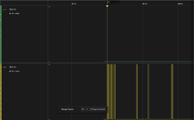

Thank you for help with this. Note that I am testing with my external custom nRF52832 board off. That board runs bluetooth/samples/peripheral_uart normally.

  • Hi Burt,
    Unfortunately, I haven’t been able to work around this, so I’ll need to file it as an internal bug report for the developers to investigate further. The assertion I encountered is also something that needs to be addressed in the Zephyr bluetooth host. If version 3.0.x is working for you, I recommend you stay on that version for now.

  • Hi Burt,
    I have now. Yes, after the fix I was able to make it work. To apply the commit I opened the terminal, CDed to the v3.1.1/zephyr folder, then ran the following commands:
    git remote add upstream https://github.com/zephyrproject-rtos/zephyr.git
    git fetch upstream
    git cherry-pick 9227a7c131a6763dfaa298e8c833373fe8c1623e
    The fix will also be included in the upcoming SDK v3.2.0 release. It's currently available in v3.2.0-rc2.
