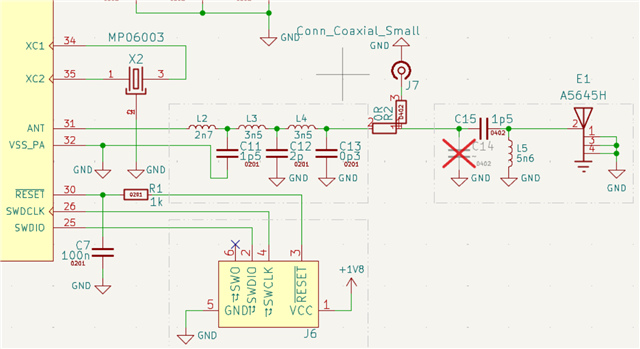

Also there is still a possibility of this being a hardware issue of some sort, but the packets are being successfully sent and received albeit very slowly.
Below I have attached a screenshot of the HF crystal and antenna tuning circuit which is a combination of reference designs from Nordic and Antennova (so likely is not perfectly tuned):
Antennova, Mica antenna datasheet:
www.antenova.com/.../Mica-A5645H-PS-1.0.pdf
