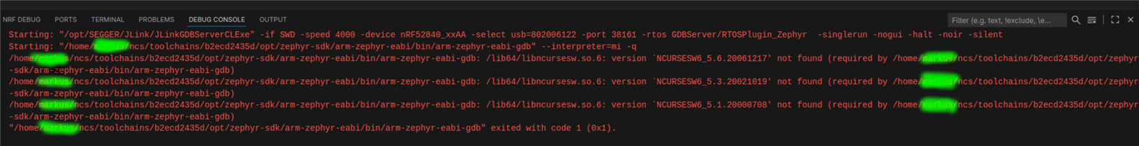

At this point, I was left with my openSUSE machine. However, debugging presented another obstacle. For debugging, I used my SEGGER J-Link EDU Mini.
While downloading and setup worked flawlessly, use with the nRF Connect for Desktop app was difficult. After many hours of research, I managed to get it running by changing the udev rule. Now I was able to flash the boards with both the nRF Connect for Desktop app and the VSCODE extension. However, debugging is not possible due to some missing module of the libncursesw.so.6 (see picture below).

I think my problem under openSUSE is that openSUSE isn't supported as far as I know.Therefore, I am lucky to even make it so far. With Windows however, I think there is a major problem with the VSCODE extension and the checksum error. It is quite annoying and frustrating to get these problems even before writing the first line of code.
