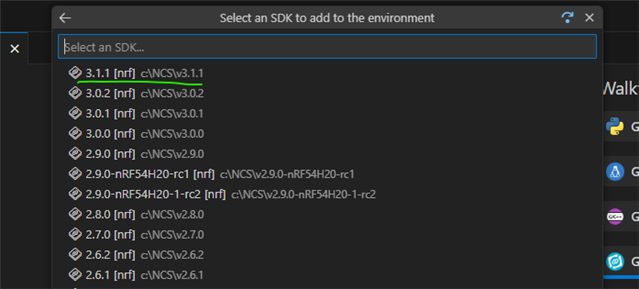

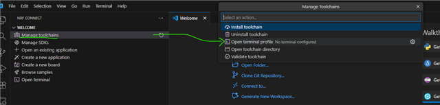

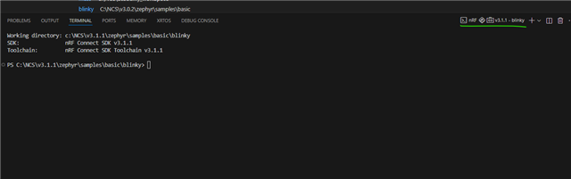

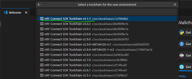

Hello everyone,
I'm trying to build the blinky sample for nrf9160 DK board using CLI. The build works with SDK and toolchains v2.2.0 and v2.9.0, but fails with v3.0.1 and v3.1.1. The issue is specific to command-line builds, It builds fine via the VS Code extension.
Any idea what could be causing this difference?
