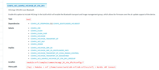

I have developed a custom application on nRF54L15 and now I want to add OTA over BLE support in it.
For that, I am following Exercise 5 – FOTA over Bluetooth Low Energy.
I tried with the BLE_LBS sample as suggested and I am able to update the firmware but not always. On few occasions the device disconnects and then OTA fails every time and need to flash the device again. Below are the logs from the sample.

I have not yet created a pm_static.yml file for partitions. Sharing the auto generated file from the build folder.
 Please let me know what am I missing?
