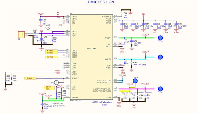

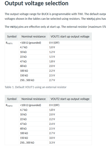

    * Just wondering what is the resistor values used for VSET pins on nPM1300 (VSET1 and VSET2)? If VBAT voltage gets closer to the voltage set by resistors, you might not get exact value you would expect, there will be some voltage drop.

    Can send me your mail id so that i can sent you the schematic for review ?
    For VSET we have used 47K register, please check the screenshot attached.
    No problem. Based on the table I shared in previous message, to get 1.8 V on VOUT2 you should use resistor value of 4.7 K Ohm not 47 K ohm on VSET2.
