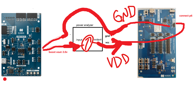

Test Configuration
The firmware is flashed to nRF54L15 PDK. The outputs of the nPM1300 in the PDK and the nPM2100EK are respectively connected to a power analyzer for testing. For the nPM2100EK, the I2C is not connected to the nRF54 PDK, and the output is directly connected.
Both,  then the power analyzer  supplies power to the PDK's P6 interface for nRF54.

With nPM2100 Power Supply:
  • Current peaks at each SLEEP_TIME_MS interval (same as nPM1300)
  • Additional small current spikes every 500ms
