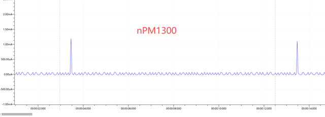

With nPM1300 Power Supply:
  • Only current peaks at each SLEEP_TIME_MS interval
  • System remains in sleep mode the rest of the time

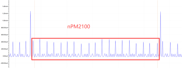

With nPM2100 Power Supply:
  • Current peaks at each SLEEP_TIME_MS interval (same as nPM1300)
  • Additional small current spikes every 500ms

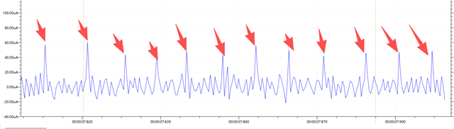

  • Very small current spikes approximately every 8ms
Questions
  1. Why is there this difference between nPM1300 and nPM2100?
    • What causes the additional 500ms current spikes only with nPM2100?
  2. What could be generating the 500ms current spikes observed with nPM2100?
    • What internal mechanism or task might be running at this interval?
  3. What causes the approximately 8ms small current spikes observed with both power supplies?
    • Is this related to nRF54 internal charging or some periodic operation?

    In very light load condition the boost refresh cycle (PFM mode frequency) would be in this time range.

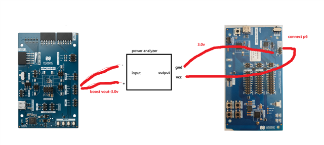

  • Could you please share how you have connected the nPM2100 with pictures/diagrams?
    Also for the second question, I was not right in my first reply. The CPU is in idle mode and the spikes you are seeing are refresh spikes from the regulator. It is turning on and off in short bursts as it tops up the output capacitor. When the voltage drops below its threshold, the regulator switches on again, causing these spikes.
    Benjamin
    HI,The circuit of npm2100 is connected in this way, and the power analyzer detects a current spike approximately every 500ms.
