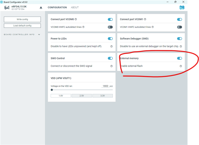

    I assume that you're working on a custom board, but just to clarify could you verify if this is the case? If it's a custom board, did you have your design in for hardware review at any point in time? Which SDK version are you on?
    Andreas
    No. I am not using a custom board. I am using NRF54L15-DK, with SDK version 3.0.2

    I think I need more info to be able to determine what might be wrong. You had a setup on your DK with an externally connected external flash that worked. The pin config is fine, and there's some changes done since you're now on a custom board
    1. How do you initialize the device in the app?
    2. I've not checked this myself, but does the driver for the device exist in NCS
    3. Verify if you see the same in https://github.com/nrfconnect/sdk-nrf/tree/main/samples/zephyr/drivers/jesd216
    4. Add a small test that does
      const struct device *bus = DEVICE_DT_GET(DT_NODELABEL(spi00));
      printk("spi00 ready: %d\n", device_is_ready(bus));
      const struct device *flash = DEVICE_DT_GET(DT_NODELABEL(at45db641e));
      printk("flash ready: %d\n", device_is_ready(flash));
    5. If both are ready, call a single spi_transceive() with a trivial buffer and log the return value.
    6. Use a logic analyzer on P2.1/2/4/5 to confirm SCK/MOSI/CS activity and whether MISO responds.
    7. If you can share the exact API call that returns -5 (e.g. spi_transceive() vs. a flash driver call) and how you reference the devicetree node in code, that might help us determining the root cause as well
    Andreas
    Thank you for your reply. The issue has been resolved after adding
    and using spi_transceive_dt() instead of spi_transceive().
