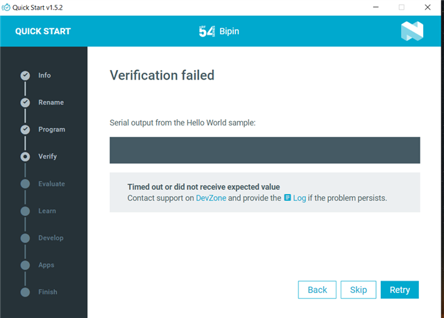

verification failed with simple hello world uart and given example in nrfconnect
please give me the solution for this issue i have uploaded simple hello world uart code with nrfconnect quick start

  • I'm using nrf54l15 dk and using quick start 1.5.2 and logs are 2025-11-14T10:20:53.990Z INFO Initialising the bundled nrfutil device

    2025-11-14T10:21:15.103Z INFO Opened port with options: {"path":"COM4","baudRate":115200}
    2025-11-14T10:21:18.448Z INFO Port COM4 still in use by other window(s)
    This is the issue. The "verify step" is just reading the log from the hello world application to check that the output is as expected. The program is unable to open this COM port (where the logs are written to) because something else on your system currently is using it. Do you have any serial terminals open that might read logs from your board?
  • Hello, I have download and used it in other pc and get same issue and no serial terminals open that read logs except this .
  • Something else is using the COM port, that is why you see the failure. Try closing everything else and just open the Quick Start application?
    Also, are you able to see logs in the VS Code extension?
