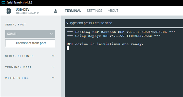

Issues initializing SPI connection between MFRC522 reader and nRF52840 dongle
Hey im new to the nordics family. Recently bought nRF52840dongle to work with a project im developing. So im using RFID-RC522 reader connected to the nRF52840 dongle via SPI. Problem is that i cant get anything out of the reader. Found some topics here all ready and tried https://github.com/mervedamar/MFRC522-NRF52 this. Changed pin configurations regarding my own physical wiring connected between nRF52840dongle and RC522 reader. From oscilloscope i could see that clock and MOSI was giving some signals. is there any samples or could you provide me some help to proceed with my project. Thanks!
    I do not have any experience with RC522 and we do not have explicit support for it, but you should be able to communicate with it over SPI and use it as I see is done in the Github repository you linked to.
    The next thing should be to debug to understand what is going on. Do you have a debugger you can hook up to the dongle? If not, an alternative is an nRF52840 DK, which has an onboard debugger (that is a better development platform in itself, and can also be used to debug the dongle).
    As you see data on MOSI the nRF is clearly attempting to communicate with the slave (RC522). Is there any data being read back? Have you analyzed the data sent from the nRF to see if it is valid for the RC522? This will be easier to check if you have a logic analyzer that can analyze SPI and show you the data. Also, have you checked basic connections?
  • Hey Einar,
    Unfortunately i dont have debugger that i could hook into the dongle. The application is running till this point i can see from terminal:
    Could the problem be how the RST or CS is handled? Cant figure out how to configure them...
  • here you can see the files and configures im using atm:
