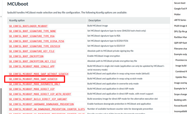

  • I'm glad to hear that it works now, thanks for the update. But it's surprising that you are experiencing these problems with the swap algorithms. Did you try the default one as well (i..e swap without scratch)?
  • Due to differences in page size between the nRF internal flash and my external SPI flash chip, effectively having a scratch partition was my only option.
    So, it was sysbuild.conf:SB_CONFIG_MCUBOOT_MODE_SWAP_SCRATCH=y & sysbuild/mcuboot/prj.conf:CONFIG_BOOT_SWAP_USING_SCRATCH=y after all.
    I did however move my scratch partition to external flash now, to free up some more space in the program memory.
