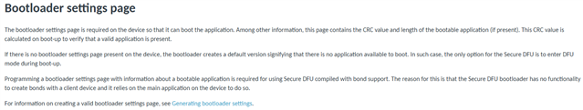

    Do you also program the Bootloader settings page file? It requires SD, Bootloader, APP, and Settings images for the BLE DFU.
    See Buttonless DFU Template Application

  • Hi Amanda,
    Thank you for the information. That was one problem. Also, we use SDK 15.3 but I think that part has not changed.
