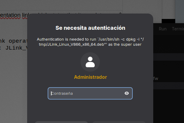

VSCode starts downloading Jlink v8.66, After downloading it asks privileges for executing:
dpkg install of a deb packace on an RPM based system.
Is it possible to access sources or other means to install this plugin?
