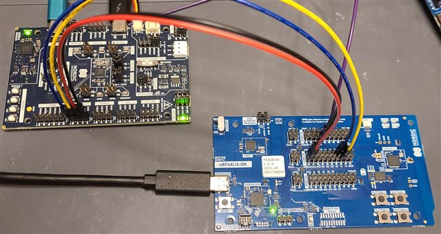

  • FYI:  I tried with my nPM1304EK and it has a similar problem.  You can see in the output that it runs for a bit, I plug in a battery (the LP181917 that comes with it), and I loose connection with it:

    In this case, I think it happened because I was trying to look at the charging config in PowerUp.  I imagine PowerUp did some sort of operation and the PMIC froze up.  I had to completely disconnect the power and reset the nrf54l15 to get the PMIC to respond again.
    Here's a pic of the boards wired together.

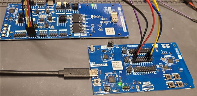

    Switching back to the nPM1300EK:
    Here's a picture of the nPM1300EK.  It's pretty much the same hook up.  I made sure the jumpers are connected as you specified:

  • Hello, and thanks for providing more information and pictures of your setup. I forwarded to our PMIC team and they point out that it is clear from description (and pictures) that the nPM Controller USB port must be disconnected when using a DK connected to the EK. PowerUP cannot be used at the same time when trying out the samples flashed onto the DK. Hence the errors - the nRF5340 SoC acting as the nPM Controller on the EK will conflict with the DK SoC (nRF54L15 in this case). Communication issues with the PMIC often result from wrong VDDIO supply.
    If the buck 1 output is used as VDDIO this is expected. When using a DK the VDDIO must match the VDD on the DK, rather than one of the bucks. But this is described in the sample READMEs
    Øyvind
