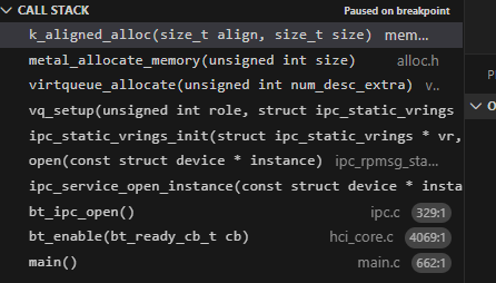

    At bootup, the network core in the Throughput sample makes just two allocations from the _SYSTEM_HEAP each of size 312 bytes (316 bytes aligned). One for the rx vring and one for the tx vring:
    static int vq_setup(struct ipc_static_vrings *vr, unsigned int role)
    	vr->vq[RPMSG_VQ_0] = virtqueue_allocate(vr->vring_size);
    	if (vr->vq[RPMSG_VQ_0] == NULL) {
    		return -ENOMEM;
    	vr->vq[RPMSG_VQ_1] = virtqueue_allocate(vr->vring_size);
    	if (vr->vq[RPMSG_VQ_1] == NULL) {
    		return -ENOMEM;
    No further allocations in the network core occur when you run the throughput test. And malloc allocations never occur.
    Those two allocations use 316*2=632 bytes.  I verified with CONFIG_HEAP_MEM_POOL_SIZE=512 that IPC init fails (<err> hci_ipc: IPC service instance initialization failed: -12). I verified the sample runs the test successfully on both sides if CONFIG_HEAP_MEM_POOL_SIZE=704. It probably can go even lower.  Regardless, 8192 seems to be way overkill.

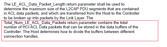

    c. What is the relation of the CONFIG_BT_BUF_ACL_TX_COUNT for the app core and network core?
     BLE on the nRF5340 splits the Bluetooth LE Controller and the host part of the Bluetooth LE stack and runs them on different cores. When splitting the Bluetooth LE Controller and the Host, run the Bluetooth LE Controller on the network core and the host part of the Bluetooth LE stack and the application logic on the application core.
    CONFIG_BT_BUF_ACL_TX_COUNT is the Number of outgoing ACL data buffers sent from the Host to the Controller. This determines the maximum amount of data packets the Host can have queued in the Controller before waiting for the to notify the Host that more packets can be queued with the Number of Completed Packets event. The buffers are shared between all of the connections and the Host determines how to divide the buffers between the connections. The Controller will return this value in the HCI LE Read Buffer Size command response.
    -Amanda H.

    c.  I was hoping to get a suggestion for best throughput such as set the CONFIG_BT_BUF_ACL_TX_COUNT in the app core to be larger than the net core's value.  Or, should the app core and net core values be equal for best throughput? Can you provide such a suggestion?
