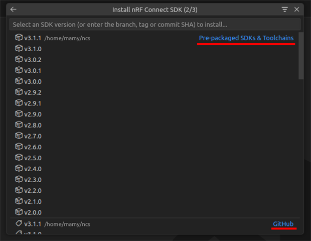

    You can use the following command to start the toolchain environment:
    nrfutil sdk-manager toolchain launch --ncs-version v3.1.1 --shell
    After doing this, you should see that it is using the shell environment for that toolchain:
    Then you can initialize west with this:
    west init -m https://github.com/nrfconnect/sdk-nrf --mr nRFConnectSDK_revision nRFConnectSDK_revision
    For example:
    west init -m https://github.com/nrfconnect/sdk-nrf --mr v3.1.1 v3.1.1
    This will create a directory named v3.1.1 and clone the manifest repository sdk-nrf into v3.1.1/nrf.
    Once this is done, you can run the following command (inside v3.1.1 or v3.1.1/nrf) to install the rest of the SDK:
    west update
