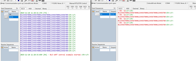

I am experimenting with ble_app_uart & ble_app_uart_c using two terminal windows, and I am sending a string of 1000 chars from the central to the device.
Although they are functioning for small strings, they both get stuck on an 1000 char string.
I increased the RT/TX UART buffer sizes on both sides to 4096 (they do not even run if I try more), but still both crash on the first attempt.
Is there an explanation for this?
Is there a solution?

    3. So I have two terminals open, connected to two Leard DVK-BL654-1.0 boards. One for Central, and one for Device. I can type small strings in either terminal, and they appear in the other. When I compose some text of about 1000 chars, consisting of 20 strings followed by CR/LF, then the Device crashes before after receiving part of it, and the central also reboots.
    4. Both projects have RX/TX buffers == 256 bytes each. I redefined them to 4096. The performance did not change.

  • The above shows what happens when I send a long string. The terminal on the left is on the central. The terminal on the right is on the device. In the left, The central, after apparently transmitting the block of strings, it rebooted. On the right, the device displays the four strings it received. After this, the device became unresponsive, i.e. i.e. it was not possible either to receive, or send short strings.

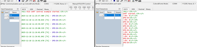

    Above is an example where both devices send and receive short strings to each other, in any order. Again, the central terminal is on the right, and the device on the left.
    Question: Should BLE be able to send a continuous block of data, or does it have to be managed in small packets?

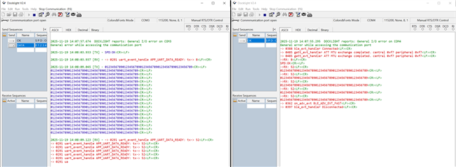

  • I have instrumented the code with printfs on both sides, and it is becoming a bit clearer. As seen on the left side, the central transmits 5 lines, and then hangs. On the right, the device receives 5 lines, and then reports that the connection was disconnected. So far, it looks like the problem is in the central.
