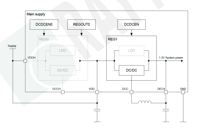

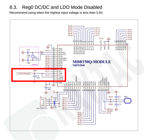

Reduce unnecessary power consumption when Reg0 is not in use
I am designing a battery-powered mobile device.
Previously, I was using Reg0 in DCDC mode, but I added an external 2.0V DCDC with higher efficiency (low Iq) and decided not to use Reg0.
According to past forums, the Iq of Reg0 (DCDC) is several tens of uA, which cannot be ignored as standby power for low-power devices.
I want to reduce unnecessary standby power consumption when Reg0 is not used.
What is the recommended way to set up config and overlay?
Reference: I am using Raytac MDBT50Q-1MV2 and the power supply circuit is as per the reference.
MDBT50Q-1MV2 reg0 disabled
