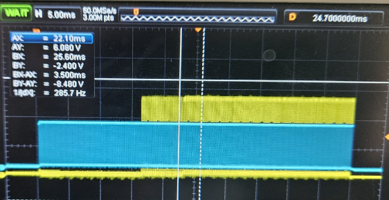

On the oscilloscope, everything looks great. WS, SCLK & SD are perfect. If I make a bit of noise, I can see the 24-bit data flipping higher bits etc. However, I can't get anything in the code. All zeros!? Any idea what's going on here? I'm sure it's something very basic I'm missing.
NB - I set it up originally as num channels = 1 - same result. And I opted for 4 bytes per sample to align for simpler memory manipulation later.

    1. Increasing block count has no effect on the apparent number of blocks collected. The maximum appears to be 4. On a scope capture, the I2S bus chatter looks like this. Crappy picture, but note 5ms per time division = about 49 ms of clock activity, and 33 ms of actual data. I'm expected 10ms per block. If I run through my code (with Block count set to 8), it tells me that 4 blocks were filled and 4 left empty. After dumping 2, I'm left with 2. I can process and free those. Why does this happen? Is there a Nordic hardware DMA limitation that is not known to Zephyr? I'm sure it's completely expected, but can anyone explain this behaviour? And how would it change with changes to the sampling duration and count? I.e. is the amount of data to dump a fixed duration, or function of block count? Is it documented anywhere? I could continue to rebuild an infinite number of configurations and check each one on the scope, but I'd rather punch myself in the face.
    If I had to guess, I'd say it spins up the clock for 1 block duration to wake the I2S device - then it captures 2 blocks (with the understanding that they will probably contain garbage), then starts actual data collection (total of 5 blocks for 2 blocks of useful data). Which would be fine if a) it was documented and b) it allowed you to capture more than 2 actual blocks of data to compensate for all of the incumbent hassle.
    edit: tested with 20ms block. total clock activity ~ 98 ms. data present for 83 ms. Therefore - above assumptions seem valid.
    edit: I suppose having increased the block size to 20, I could now avail myself of all 4 captured blocks the init time having been empirically determined to be about 17ms in this case... Would probably be better to add an interrupt into the driver that triggers after a configurable delay from when data starts coming in...
    2. After processing and freeing the 4 blocks, I execute a trigger STOP command. Although the exact usage of this is not clear - I don't think it's actually doing anything in this case. I did find that the subsequent start would not work effect unless I added a PREPARE cmd after each loop - presumably recovering from an error condition (??? clue ???). With that, it will go round the loop again, collecting and processing a further 4 (2 useful) blocks... While I'm delighted that it's collecting and allowing me to do something with the blocks, having to reverse engineer the whole thing like this is making me miserable and wasting a lot of time.

    Update: I've gone rooting around inside i2snrfx.c just out of curiosity, and noticed this config `CONFIG_I2S_NRFX_RX_BLOCK_COUNT ` being used. Seems important?! So, I added an assignment to it in my main.c and ctrl clicked to see where it went:
    #define CONFIG_I2C_NRFX 1
    #define CONFIG_I2C_NRFX_TWIM 1
    #define CONFIG_I2C_NRFX_TRANSFER_TIMEOUT 500
    #define CONFIG_I2C_INIT_PRIORITY 50
    #define CONFIG_I2S 1
    #define CONFIG_I2S_INIT_PRIORITY 50
    #define CONFIG_I2S_NRFX 1
    #define CONFIG_I2S_NRFX_RX_BLOCK_COUNT 4
    #define CONFIG_I2S_NRFX_TX_BLOCK_COUNT 4
    The above stuff is inside my build folder!? In autoconf.h. It seems a bit rum that this value of 4 is in there. In my prj.conf I only set `CONFIG_I2S=y`: none of that other stuff... It must get pulled in through a Kconfig that I wasn't aware of being applied.
    Update:
    This stuff comes from kconfig.nrfx inside of zephyr/drivers/i2s. This confuses me.
    a) I thought I wasn't using the nrf i2s code - but rather the OS agnostic Zephyr library.
    b) The smoking gun is that this hardware config limitation is preventing the Zephyr I2S code from working - but it doesn't set off any alarm bells during build.
    The fix is something like:
    #define BLOCK_COUNT  MIN(CONFIG_I2S_NRFX_RX_BLOCK_COUNT, 8)
