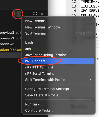

    The hash for the toolchain does not match the one I have for 3.1.1 on Mac. How did you open the terminal in VS Code? In order to get a terminal with the toolchain you should open from here if you use VS Code:
    Then you will also see the SDK and toolchain printed in the terminal so you can verify it is correct. Like this:

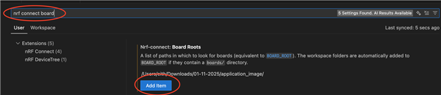

    Regarding custom boards, you can add the path to the boards folder in VS Code where you edit the VS Code settings like this:

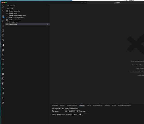

  • I started the terminal from the nrf sdk menu top left, seems to give me the same thing.

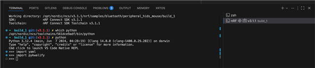

  • I see. Can you check which python install is being used by typing "which python" in the terminal window? It could be interesting to try to import the missing packages there as well. Similar to what I did here:
    Also, I am wondering if you are testing on an Intel or ARM based Mac? (I am not reproducing on my ARM based).
