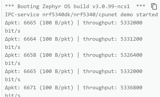

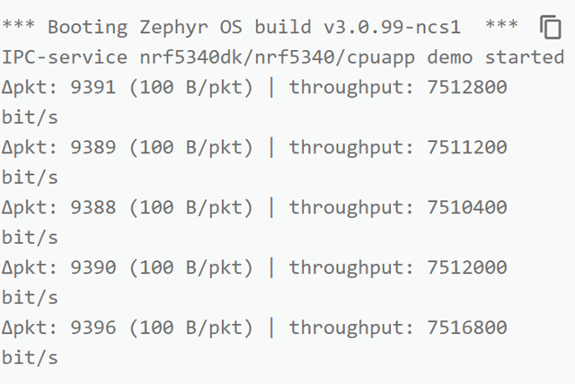

I found out that netcore (cpunet) does not have access to ADC, so what I did was that cpuapp collects data from the ADC and then sends it to cpunet using IPC.
My IPC communication is based on ipc_service from this path in SDK files: "\ncs\v3.1.1\nrf\samples\ipc\ipc_service".
I am using the same functions (ep_recv with small modification) to send and receive IPC messages on cpuapp and cpunet.
This functions are: ep_boundep_recv
ipc_service_open_instanceipc_service_register_endpoint ipc_service_send.
Part of the application on cpuapp is ipc_service sample that is extended to collecting data from ADC, and sending this data to cpunet via IPC.
Part of the application on cpunet is timesync-demo that is extended to sending and receiving data via BLE, and receiving data from cpuapp via IPC.
I want to send ADC data from receiver to tramsmitter via BLE every 10 ms.
QUESTIONS:
Will the IPC implementation slow down my application or is it fast enough that I can read data from the ADC on cpuapp every 10 ms (or even every 8 ms), then send it via IPC to cpunet, and then send it from cpunet to the receiver via BLE ?     [ each of these steps should occur every 10ms ]
How much data (how many Bytes) can be sent via IPC so that the transmission does not slow down the rest of the application ?
Can cpuapp and cpunet communication via IPC work both ways equally well (cpuapp -> cpunet or cpunet -> cpuapp) ?
If I want to establish two-way IPC communication, do I need to add additional mechanisms to avoid errors or data loss ?
Is the method of sending data via IPC presented in the "ipc_service" sample (extended to send data array from ADC) suitable for my purposes ?
Are there other better methods or perhaps different functions that should be used in the final application ?
