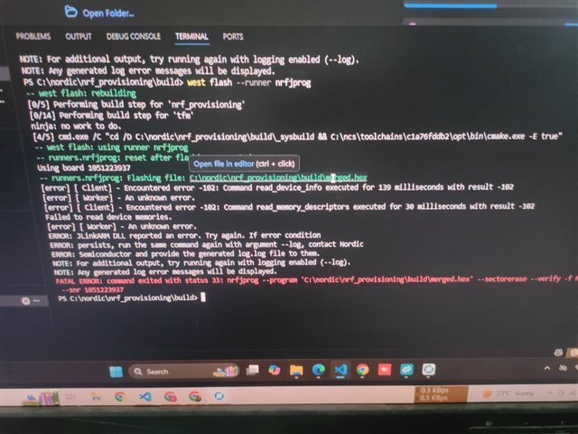

  1. west flash fails immediately with Error -102.
  2. nrfjprog --recover -f NRF91 fails with Error -21.
  3. The J-Link logs show "Device error: Setting the debug port SELECT register failed."
Error Logs: When trying to flash:
-- west flash: using runner nrfjprog
-- runners.nrfjprog: reset after flashing requested
Using board 1051223937
-- runners.nrfjprog: Flashing file: C:\...\merged.hex
[error] [ Client] - Encountered error -102: Command read_device_info executed for 139 milliseconds with result -102
[error] [ Worker] - An unknown error.
[error] [ Client] - Encountered error -102: Command read_memory_descriptors executed for 31 milliseconds with result -102
Failed to read device memories.
FATAL ERROR: command exited with status 33

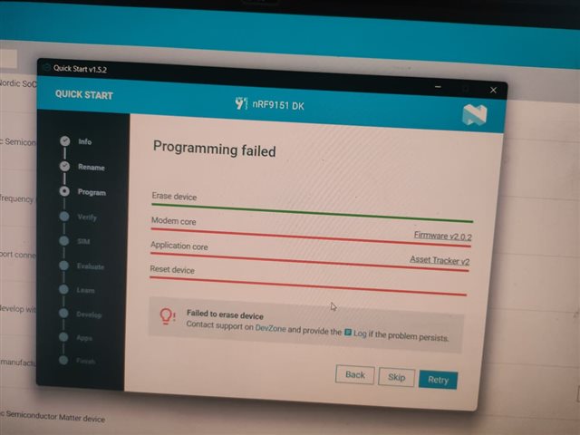

Due to some circumstance I don't have nrf9151dk physically right now. i'm debugging it using remote platform rustdesk. When i'm trying to flash it with quick start guide of nrf connect i'm getting:
when i'm trying it with vs code i'm getting:
