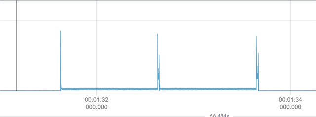

I have a timer setup that, when it fires, every 5 seconds, it will take two ADC readings. This looks like:

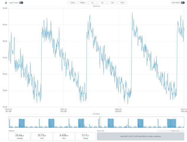

When my code is idle (before and after these three spikes), it's still drawing an average of 28µA. Using the PPKII, I've zoomed in and you can see the saw tooth shape.
