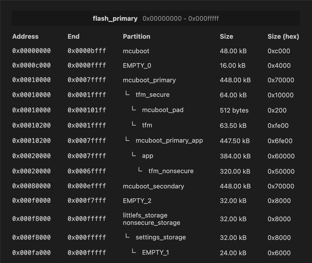

And this is the flash partitioning of the old firmware:

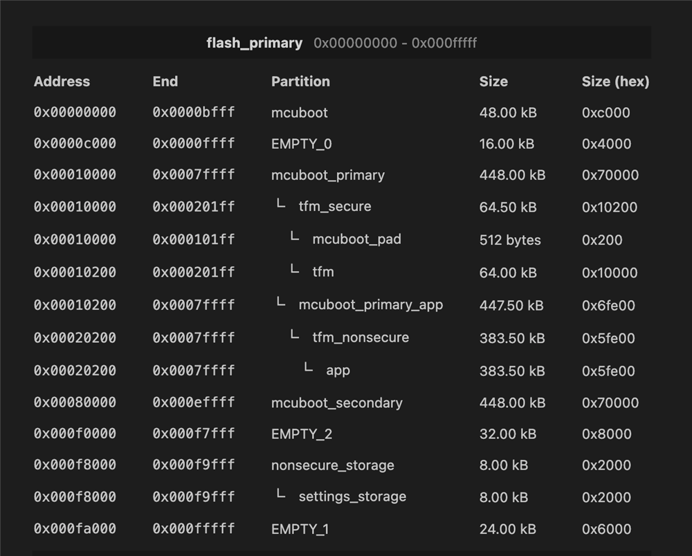

To solve this issue I modified the partitioning to this:
When I try to update the firmware via FOTA, After finishing downloading the firmware, I get "Image in the secondary slot is not valid!" and the firmware goes back to the old one.
This happens when the old FW is running and I want to upgrade it to the new one, If I do the fota for the same old fw the process completes successfully.
