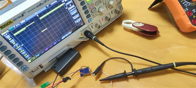

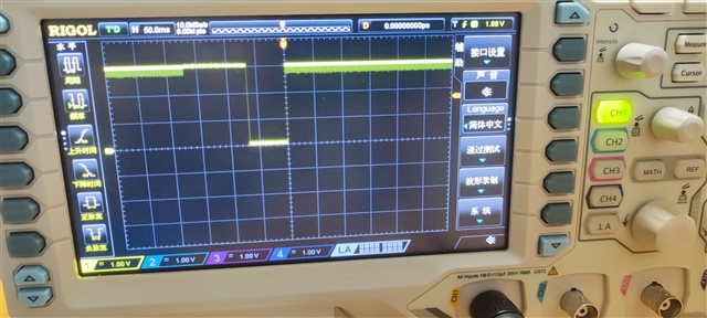

Hi,I made a 52840 board ,it's p0.18 hanging, without connecting a 10k pull-up resistor and a 100nf capacitor to ground. I connected 3v3, GND, SWDIO, and SWDCLK from the 52DK board to this board, and successfully downloaded software from NCS to it. But only when the jlink RTT Viewer of the PC is connected to this board, its software runs. and the rtt viewer doesn't show any log info of  52840.When the RTT viewer disconnected, 52840's software stops.
When I only connect 3.3v and GND to this board, its software doesn't run。What is the reason?
