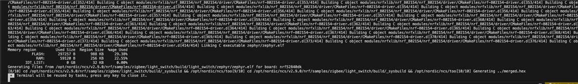

  • Hi  !
    Thanks again for your reply
    With the board nrf52840dk/nrf52840 I can compile, but after uploading on my board, nothing happen... No error, no COM serial port appearing, nothing in HomeAssistant.
    So I tried to build with `nrf52840_mdk_usb_dongle`
    Unfortunately, with the board `nrf52840_mdk_usb_dongle` I have this issue:
    [421/424] Generating isr_tables.c, isr_tables_vt.ld, isr_tables_swi.ld
    FAILED: zephyr/isr_tables.c zephyr/isr_tables_vt.ld zephyr/isr_tables_swi.ld C:/ncs/v2.9.0/nrf/build/light_switch/zephyr/isr_tables.c C:/ncs/v2.9.0/nrf/build/light_switch/zephyr/isr_tables_vt.ld C:/ncs/v2.9.0/nrf/build/light_switch/zephyr/isr_tables_swi.ld
    cmd.exe /C "cd /D C:\ncs\v2.9.0\nrf\build\light_switch\zephyr && C:\ncs\toolchains\b620d30767\opt\bin\python.exe C:/ncs/v2.9.0/zephyr/scripts/build/gen_isr_tables.py --output-source isr_tables.c --linker-output-files isr_tables_vt.ld isr_tables_swi.ld --kernel C:/ncs/v2.9.0/nrf/build/light_switch/zephyr/zephyr_pre0.elf --intlist-section .intList --intlist-section intList --sw-isr-table --vector-table"
    gen_isr_tables.py: error: multiple registrations at table_index 39 for irq 39 (0x27)
    Existing handler 0x4f9b3, new handler 0x4f9b3
    Has IRQ_CONNECT or IRQ_DIRECT_CONNECT accidentally been invoked on the same irq multiple times?
    FAILED: _sysbuild/sysbuild/images/light_switch-prefix/src/light_switch-stamp/light_switch-build C:/ncs/v2.9.0/nrf/build/_sysbuild/sysbuild/images/light_switch-prefix/src/light_switch-stamp/light_switch-build
    cmd.exe /C "cd /D C:\ncs\v2.9.0\nrf\build\light_switch && C:\ncs\toolchains\b620d30767\opt\bin\cmake.exe --build ."
    FATAL ERROR: command exited with status 1: 'C:\ncs\toolchains\b620d30767\opt\bin\cmake.EXE' --build C:/ncs/v2.9.0/nrf/build
    I Googled quickly and added following line to prj_usb.conf:
    CONFIG_SHARED_INTERRUPTS=y
    And then had this error:
    -- Configuring done
    -- Generating done
    -- Build files have been written to: C:/ncs/v2.9.0/nrf/build/light_switch
    -- Configuring done
    -- Generating done
    ←[92m-- west build: building application
    [5/10] Performing build step for 'light_switch'
    [4/425] Generating include/generated/zephyr/version.h
    -- Zephyr version: 3.7.99 (C:/ncs/v2.9.0/zephyr), build: v3.7.99-ncs2
    [422/425] Generating isr_tables.c, isr_tables_vt.ld, isr_tables_swi.ld
    gen_isr_tables.py: error: Attempting to register the same ISR/arg pair twice.
    (v2.9.0) C:\ncs\v2.9.0\nrf>
  • The MakerDiary nrf52840_mdk_usb_dongle board configuration you are compiling for does not activate the Zigbee stack. Consequently samples/zigbee/shell fails in Kconfig with the error " symbol ZIGBEE…​”: the board does not choose the IEEE 802.15.4 radio nor the Nordic Zigbee elements therefore those symbols are absent.
    When switching to the Nordic Connect SDK  and compiling the Zigbee shell, with the Nordic nrf52840dongle_nrf52840 board (west build -b nrf52840dongle_nrf52840 nrf/samples/zigbee/shell) the build finishes successfully since that board configuration already includes ZBOSS and the 15.4 driver.
    If you prefer to stay on the MakerDiary board, you will need to clone/override it in your tree and add the missing capabilities like set CONFIG_HAS_HW_NRFIEEE802154=y, pull in the Zigbee defconfig snippets, make sure the pin mapping matches the dongle. Without that, any Zigbee sample might be stopping at Kconfig because the required subsystem is never enabled for that board.
