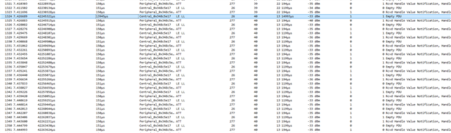

    So you queue a packet every 9ms.
    The problem is that the BLE stack send all the packets buffered really quickly about 1.4ms each packet.
    So by the first 10ms for example already up to 7 packets can be sent. This can empty out all the buffered packets that you queue.
    When the buffer is empty the connection event will be completed. No more packet will be sent after that.
    You need to queue faster than sending or you need to have larger buffer.
    For example when you queue every 1 sec you can send 19 packets in a 50ms interval:
    To have larger buffer, you will need to increase CONFIG_BT_CTLR_SDC_RX_PACKET_COUNT and
    CONFIG_BT_CTLR_SDC_TX_PACKET_COUNT .
    Try to set
    CONFIG_BT_CTLR_SDC_TX_PACKET_COUNT=10 on the peripheral
    and
    CONFIG_BT_CTLR_SDC_RX_PACKET_COUNT=10 on the central.
    You will see 9-10 packets queued for each connection event:
    Before (3):
    After (9):
    Note that if you still keep the sending rate at 9ms each, you will still run out of buffer and result in what you see above, after 9 packets sent, it just stopped and wait for the next connection event.

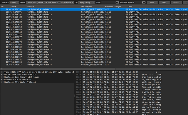

    By the way, may I ask if I don not use "queue a packet every 9ms", is there any way to control the throughput around 200kbps? The TX ans RX is close to each other so I can not reduce the TXP or increase distance. I have to test the pair at a certain throughput level.
    I have tried that delete the ksleep to ask the peripheral sending continuously, however,  I still can only get low througput around 10 kbps. (I have added CONFIG_BT_CTLR_SDC_TX/RX_PACKET_COUNT)
    Thank you!

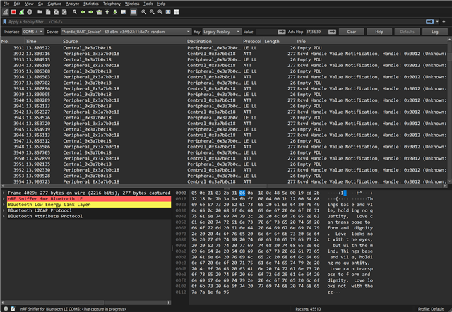

    Please capture a sniffer trace.
    You can see in my screenshot, the only modification I made was change the delay to 1ms and I can see 19 packets in a 50ms interval. So there must be something wrong.
    You can control how much you send by counting what you queue.
    What is your application and why you want to keep the throughput at 200kbps ?

    I make it send continuously an the trace file is here:
    3200 continiously.pcapng
    How could I control how much I send by counting what my queue? I want to do this because I want to check the synchronization effect at different connection interval. (with certain througput)
    My current code is
