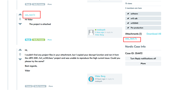

    Power consumption cannot be reduced after using hardware encryption. Under normal conditions, the device power consumption is 30µA, but after calling aes_cbc_decrypt, it increases to 3.4mA.   SDK is nrf5 17.0.0,how can I reduce power consumption?

    Generally we recommend using the nrf_crypto API on top of the cryptocell API (AES samples with cc310 can be found in /crypto/nrf_crypto/aes) which takes care of powering down the cc310 after use, but I see you ahavee SaSi_LibFini() at the end there which should have the same effect. Have you tried to debug your application to verify whether the program returns from this function and starts executing the __WFE()/__WFI() after?
