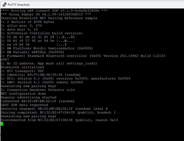

Hi support:
When testing the peripheral nfc pairing sample on the nRF54L15-DK development board, and using an Android phone for testing, it was found that the phone's Bluetooth could not establish a connection with the development board's BLE.
Below is nRF54L15-DK log.

Connected 57:B8:32:25:6E:72 (random)
Notified HID service about connection
LESC OOB data requested
Security changed: 57:B8:32:25:6E:72 (random) level 4
Pairing completed: 84:A1:B7:D0:CF:7C (public), bonded: 1
Generating new pairing keys
Disconnected from 84:A1:B7:D0:CF:7C (public), reason 0x13

  • It was my colleague's mobile (as I don't have an Android). He is out of office today, so I can't ask him. What phone model are you using?
    AndrewXu said:
    The "Disconnected" occur after a while.
    Does that mean that it successfully connected and paired then? Was it added to the list of known devices (in android settings -> Bluetooth)?
