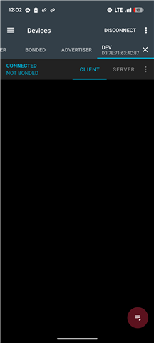

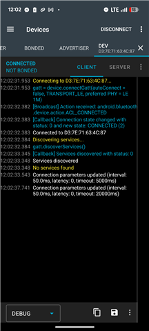

I had a fully working BLE setup on my nRF52 (Zephyr), which worked fine on older Android versions. After updating a phone to Android 16 (tested on Google Pixel 7 and Samsung S24), a problem appeared: the nRF Connect app (version 2.9.2) stopped discovering any BLE services.
After investigating and disabling individual services in my project, it turned out that the Device Information Service (DIS) is causing the issue. When DIS is disabled, Android 16 correctly discovers all other services.
Currently, my application only has DIS enabled, and I cannot determine why Android 16 fails to discover any services, while older Android version work correctly.
I also ran the Zephyr DIS example directly and  Android 16 correctly discovers all services. This suggests that the problem is likely in my implementation, but I have not been able to identify the cause.
From RTT logs, I was able to observe that Android 16 discovers services differently compared to older Android versions, which might be related to the issue. Any help or suggestions would be greatly appreciated .
  • RTT logs from older Android (working correctly)
  • RTT logs from Android 16 (services not discovered)
  • Screenshot from nRF Connect showing no services

  • We have tested this on two Android 16 devices using three different applications: nRF Connect, our own app, and another BLE application (BLE Scanner – Connect & Notify). On both devices, none of the applications were able to detect any services.
    For reference, the build number for one of the Android 16 devices is BP4A.251205.006.
    Currently, we do not have a minimal example project that reproduces this issue, but I will prepare one and share it with you as soon as possible.
