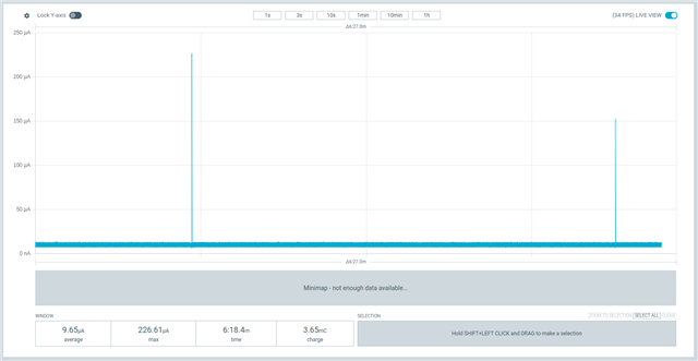

Dear All,
I am developing an application where I need to get the nRF5340 to the low power state, where the chip is consuming less than 10uA when it idle, while using the nRF7002 companion chip.
Starting with the simple blinky example, adding to the prj.conf
CONFIG_LOG=n
CONFIG_SERIAL=n
I am able to get the device to work with about 10uA on average.

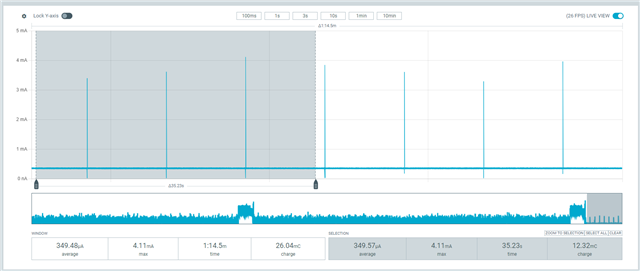

I have tried the following Kconfigs as well, but without any changes:
CONFIG_TFM_LOG_LEVEL_SILENCE=y
CONFIG_NRF_WIFI_LOW_POWER=y
CONFIG_NRF70_QSPI_LOW_POWER=y
I have also tried allowing for serial in the prj.conf and powering it down in the code, setting the corresponding Kconfigs, but that also did not work.
I have also seen this article https://devzone.nordicsemi.com/nordic/nordic-blog/b/blog/posts/optimizing-power-on-nrf53-designs
and tried to add the prj.conf in the sysbuild/ipc_radio described in step 1. This also did not made any difference.
I think that the issue that I am seeing is that the project is being built with the CONFIG_PINCTRL.
I am using nRF connect SDK v3.1.1.

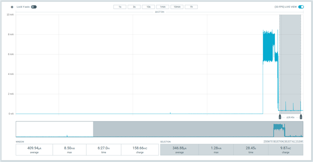

    I have followed the instructions in the link you posted as well, without any improvement.
    But I would like to ask you a few things first. Is it fair to expect that the nRF5340, when it is idle it should be consuming something like 10uA?
    The second thing that occured to me is that the CONFIG_SERIAL=n would remove also the QSPI functionality that is needed for the communication between the host and the companion chip.
    Based on the prj.conf that I have given you and the simple main with the sleep loop, what is the expected current consumption on the host side?
    I have used code from different samples found in zephyr (tcp) and nrf (https_client) as well as other examples related to connecting to an AP.

    What I am observing is that with the CONFIG_WIFI=y commented out my current consumption indeed drops to <10uA:
    If I uncomment the CONFIG_WIFI=y setting I am seeing the ~340uA offset (see the selection part):
    So, I wonder is there any configuration that could reduce this consumption?
